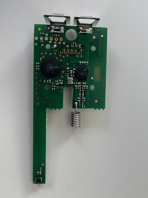

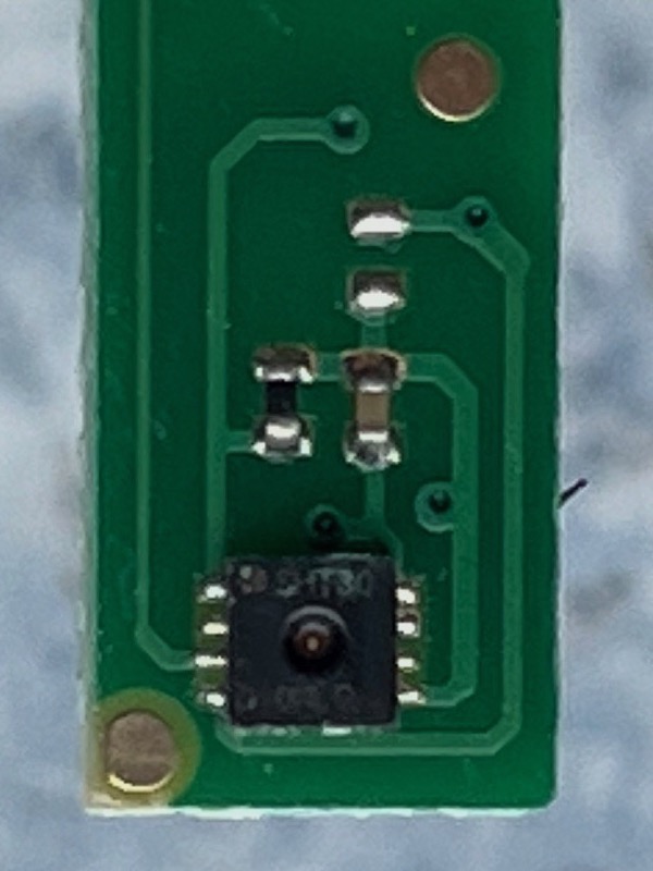

I also bought TFA Temperature/humidity Transmitter 30.3180 (especially for its precision Sensirion SHT30 sensor) :
https://www.tfa-dostmann.de/en/product/ ... r-30-3180/
Transmission frequency is 868 MHz as per its technical data, also as per its instruction manual (every 10 seconds).
Perfect.
When I use RFLink Loader in Serial Port Logging mode, Debug on, I see DEBUG Pulses lines from time to time.
Seems then my RFLink Gateway receives "things". I even captured a door bell
But no line seems to correspond to my TFA transmitter
Its transmission icons blinks every 10 seconds, but the Arduino LED does not blink at the same time / does not blink at all.

Re: Nodo 868 RFLink & TFA IT transmitter
Unsupported devices should show debug data if they use the same frequency and modulation type of the used receiver hardware module.
Additionally they need to be within the ranges of accepted pulse length.
I have some question marks around the modulation type, it might not use ASK/OOK but rather use FSK for the IT line.
