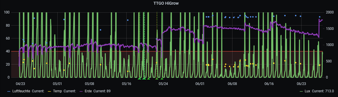

Running roughly 2 months with 10 minutes intervals and 1sec uptime.
But sadly with that short uptime it doesn't properly measure temperature and ommit's it mostly.
Oh... and you can see when i unplugged the Sensor on 05/24, some dirt was still stuck on it So it increased from 40-60 Range to 60-80 range....
Re: TTGO T-Higrow ESP32 Plant Sensor
What does the red line represent?
That's the automatic Battery Warning of 3.3V from Grafana.
Not a graph but a system value
