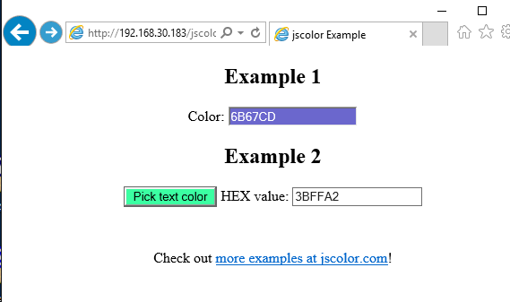

In my case I like to use ESPEsay as an actor. I know that is not the main purpose of ESPEasy, but I hope/think it will work.
I´d like to controll my self build living room light with ESPEasy.
That lamp uses RGP stripes (WS2812) and some LED lights which need to be dimmable.
Using SPIFFS allows me to serve a small webpage with a color selector for the RGP Stripe. I know this could also be done by embedding the javascript code.
But using SPIFFS would make life much easier

Hi !
Just a small note about SPIFFS here.
I build R131 with SPIFFS enabled. Works like a charm Thx for fixing that !!
And it seems to be very easy to get my "RGB-lamp" project setup ...
Attached two first test screens
Loading javascript from a webpage is also no problem for SPIFFS. Excellent
But I will open a new topic in Projects for that.
- SPIFFS RGB Color Picker.PNG (13.47 KiB) Viewed 20020 times
- SPIFFS Filelist.PNG (19.4 KiB) Viewed 20020 times
