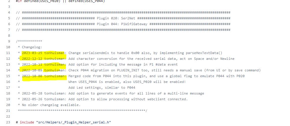

I want to use MQTT with ser2net so I follow the link https://github.com/letscontrolit/ESPEas ... 3698876078
Source code (probably changed) https://github.com/tonhuisman/ESPEasy-1 ... out-client
Change log P020 (missing on new source P020 file?)

Re: ESP Easy Ser2net no message in MQTT (P020)
When you look at the commits for that pull request, you'll see the commits since 2023-03-25 were just 'merge mega' commits or in other words they are just to keep the PR in sync with other merges to the main branch.
So no changes since the 25th seem OK to me.
Downloading ZIP files is always a bit tricky as you never know whether you create issues by not deleting previous files which have been renamed.
The better way is to use any Git tool to checkout specific branches.

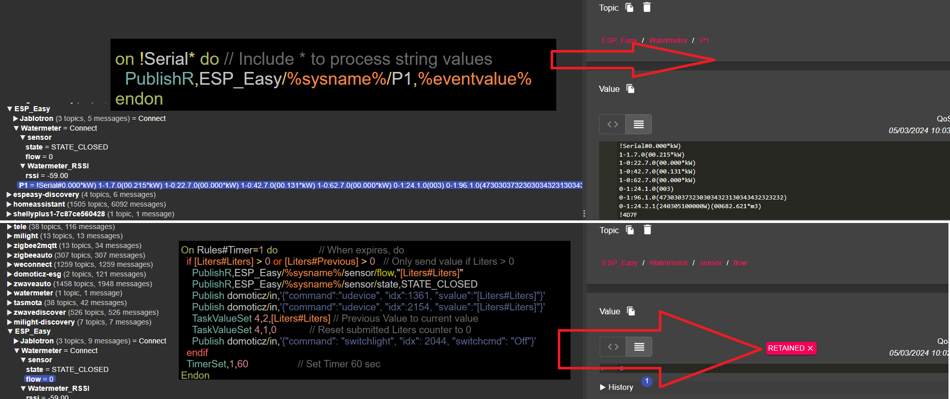

Thanks so much for all the help in this thread.
I recently installed the 20240229 - Mega with the Communication - Serial Server to read data from my P1 port.
Domoticz has direct access to this communication serial server, but I also wanted a second controller (Homeassistant) to be able to see the data.
By putting the Communication - Serial Server Event Processing on 'Generic' and adding the rule:
All the data is now shown by my MQTT broker and Homeassistant is able to retrieve data from it.
has been recently added to Publish with Retain, however this seems not to work for !serial but does work for other mqtt messages that is publish.
To process it I only needed to create some interpretation rules.
https://github.com/sincze/Homeassistant ... nergy.yaml
on !Serial* do // Include * to process string values
PublishR,ESP_Easy/%sysname%/P1,%eventvalue%
PublishR
Let me try to explain.Ath wrote: ↑04 Mar 2024, 21:04 Thanks for sharing your info and configuration, that'll be helpful to a lot of people.
But this remark is unclear to me:I don't see the relation between the PublishR command and !serial, other than to publish data to the MQTT server. Why wouldn't it send out the message?
You can of course add a lineto your event, to see what's actually sent in the logging.Code: Select all
logentry,'Sending to MQTT: %eventvalue%'
It publishes !serial message just fine
However retain flag is not set. I just dont see that with mqtt browser.
The other messages that i publish with same command publishr do set the Retain flag.
Hm, can this be a setting on HA side, not retaining messages larger then a specific size? As I've been unable to find something similar in ESPEasy, and as it was me that added the PublishR command, I'm pretty sure there's no special condition for the retain flag not being set for the PublishR command iow: PublishR always sends out the message with the retain flag set.
Sir I am truly happy with your modification and can thank you enough.Ath wrote: ↑04 Mar 2024, 23:24 Hm, can this be a setting on HA side, not retaining messages larger then a specific size? As I've been unable to find something similar in ESPEasy, and as it was me that added the PublishR command, I'm pretty sure there's no special condition for the retain flag not being set for the PublishR command iow: PublishR always sends out the message with the retain flag set.
Please find attached the rules I used with PublishR and the monitored result in MQTT Browser. As you can see for FLOW it sets RETAINED flag the other for P1 it did not.
