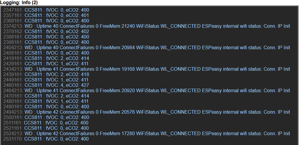

Once again many thank for your help. This is really very kind. I always forgot the I2C scan under tools. Scanning doesn't find any device either on 0x5A nor on 0x5B but I changed the settings and enabled "Force Slow I2C speed" and suddenly I had TVOC: 0.0 and eCO2: 400.0.
Logging Info was showing some changing values with "Take reading every: 1 seconds" and also if it is set to 10 seconds.
I have my sensor right next to my notebook in the living-room. Does this make sense with these values? I don't know if they are reliable. TVOC always stays on 0 or it changes to 1 or 2 and goes back to 0. Both values seem to be very volatile.

Well the CCS811 isn't a true CO2 sensor.
It is measuring a number of volatile organic gasses and by the ratio (and concentration) of those, it computes some value which the named "eCO2".
The values reported by that sensor also fluctuate a lot.
Just set it to update once a second and blow at it.
You should see it spike for a short while.
I don't think you can use the sensor to measure the true CO2 concentration in the room.
For that you really need a true CO2 sensor like the MH-Z19 or the SenseAir S8 or S11 (Sunrise).
The MH-Z19 does also have its quirks, but at least it does measure the CO2 concentration instead of estimating it based on a lot of other gasses which in some situations also show some relation to the CO2 value in a room.
